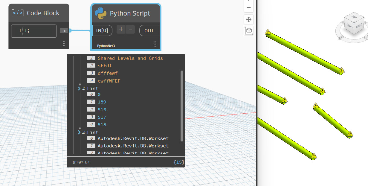

hi @Boopalan.M82E8U you have 20 user created workset the node give 64, try filter for only user created as i think Jacob mean as well…
import RevitServices
clr.AddReference("RevitAPI")
import Autodesk
import Revit
app = uiapp.Application
refresh = IN[0] if len(IN) > 0 else False
userWorksets = FilteredWorksetCollector(doc).OfKind(WorksetKind.UserWorkset)
names, ids, worksets = [], [], []
if userWorksets:
    if refresh:
        for workset in userWorksets:
            names.append(workset.Name)
            ids.append(workset.Id.IntegerValue)
            worksets.append(workset)
else:
    names.append("No worksets found")
    ids.append(None)
    worksets.append(None)
OUT = names, ids, worksets
and elements on these workset can still give you result you dont expect maybe, lets say a duct, it will give you the duct oc. but also mechinical system etc basic all there belong to your workset…so again filter that down so only select duct so you can pin
