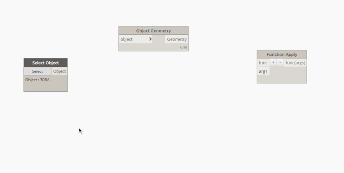

If the warnings become annoying, you can “swallow” them by using a _Function.Apply_ node.
 ![FunctionApply](https://us1.discourse-cdn.com/flex022/uploads/dynamobim/original/3X/1/d/1d525c348604310cef33720dbb1a9211beb14de6.gif)
