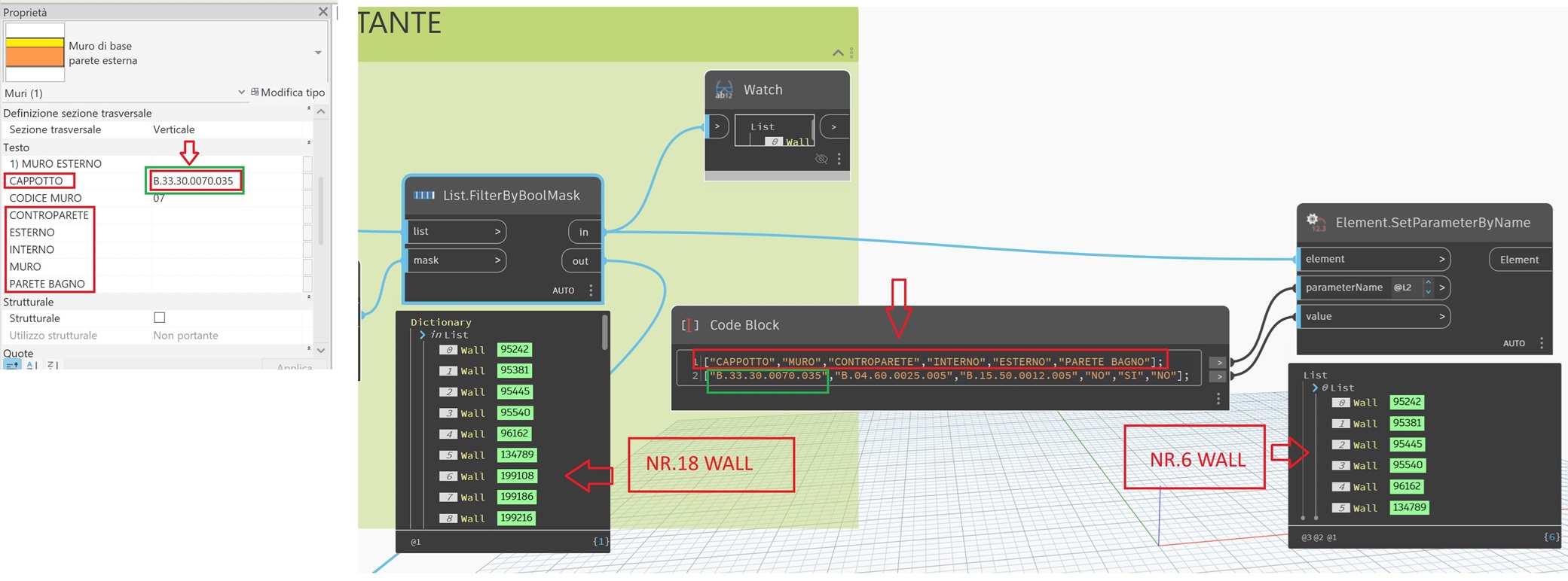

Nodo Element.SetParameterByName
I created parameters for walls:
CAPPOTTO
MURO
CONTROPARETE
INTERNO
ESTERNO
PARETE BAGNO
I enter the values, but it doesn't accept them.
Also, there are 18 walls, and I only get 6.
Any help?
Lacing and list level issue.
Try to set the input for “element” to @L1 and remove the list level on the parameter name.

Solved as you indicated... thanks
