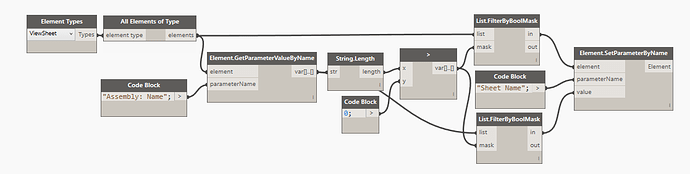

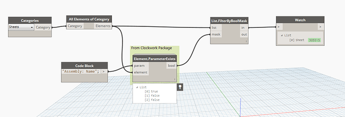

I am wanting to rename the assembly sheet that is automatically generated when making an assembly with the assembly name, but I cannot find a way to filter only assembly sheets. Is there an OOTB parameter/category that makes an assembly sheet unique to other sheets in the project that can be used with Dynamo to filter?
All I can say is WOW! Works like a charm. Thanks to the both of you! Einar, sorry but I went ahead and used Kulkul’s graph since it did not involve any additional python code… Thanks again guys for the assistance! I will go back and look at my graph on setting Sheet Name to match Assembly Name and compare to your Einar! Now on to the next piece… placing views on sheets… i’m am doing the research now so I can get this one done as well
Sorry about the python, it’s easy to overlook the obvious sometimes. The last graph is completely python- and custom node free.
