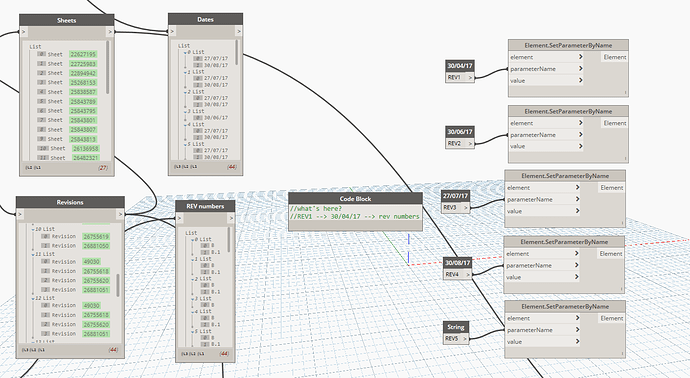

I have a list of sheets, a list of revisions per sheet (revisions are sublists) and the dates for each revision in a list (see image below)
I want to feed the revision number per date per sheet into a text parameter to create a kind of revision history.
So Sheet 1 will have REV1 parameter where the given date revision number should go. Then to REV2 parameter the next date’s revision number and so on…
I was able to do it with filter by boolean and a lots of node but I feel it too manual to expand, too many nodes.
I’m really curious what is a more clever way to do it.
