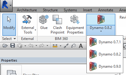

The latest stable build, along with a recommended core set of packages, is deployed along with current versions of Revit. This means all Revit users, regardless of whether or not they actively use Dynamo, have the same Dynamo “ecosystem.”
Therefore it falls on me, each time a new stable is released, to go through each and every recommended package (16 at this point) and identify the most recent version built to the stable.
