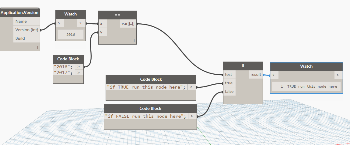

You could try this.
Add your 2016 Code to the True, and 2017 to False if that’s the case.
Not sure what you are doing with your graph in the different versions but the logic is there.

The result on the right of the IF is for the TRUE option. So you can hook your node up to that. You could duplicate the nodes if you need to in order to complete the opposite.
Without seeing what you are doing it’s just a guess.
