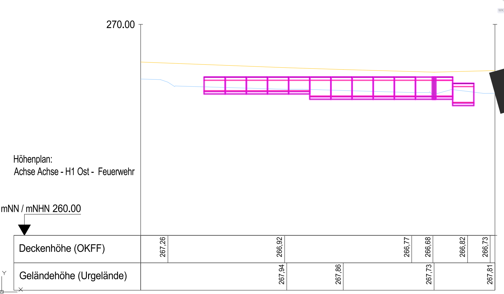

Hi.
Does anyone have an idea how I can get the position of the projected objects in a profile view and whether I can create a link to the original blockreferences in the site plan so that I can extract information from the dynamic blocks in Dynamo?

Can you attached example drawing
Are you able to use Civil 3D 2026? It should fix this issue.
Not at the moment.
But I’ll have it installed and tested when I get a chance.
