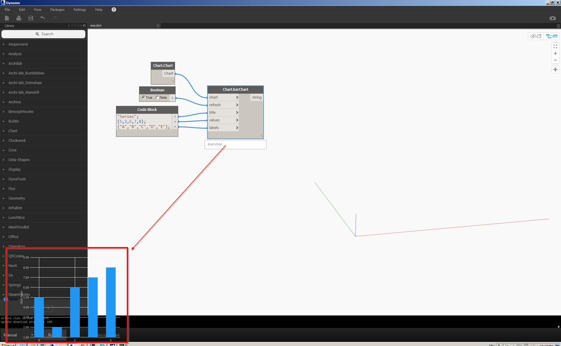

@Cesare_Caoduro3 it looks like you have the run mode set to Manual in your screenshot - if it is set to Automatic then the graph should re-execute downstream nodes when you change any input.
I know is not in Automatic mode but this is not what I’m talking about. If you try Mandrill package, Kornad is able to refresh the chart every time the input values are changed and, this is exactly what I would like to achieve.

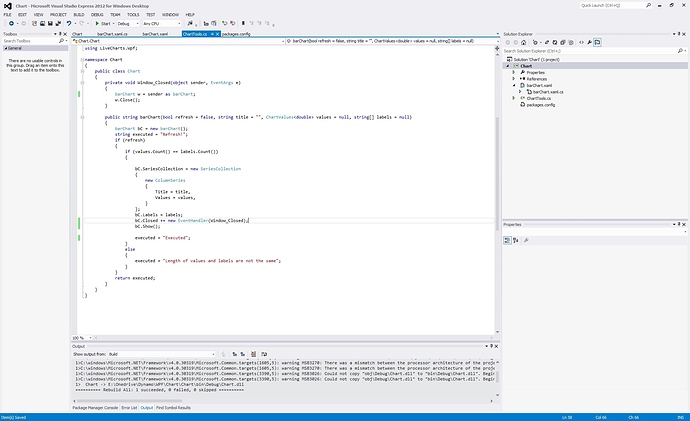

- if you are writing a UI node, (inheriting from nodeModel) you can call OnNodeModified(true) to force execution of that node.
