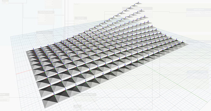

Hi @Patrick.Scholl,
here’s a suggestion : Panel.Quad from Lunchbox package can save you some time.

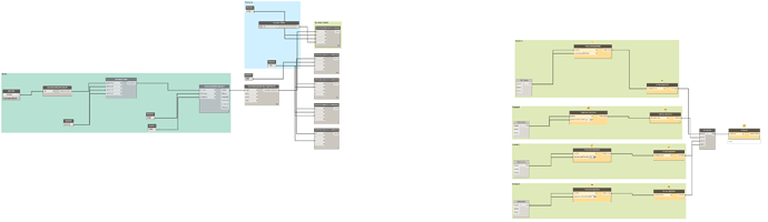

make sure the lacings are set to longest as shown in the screenshot!

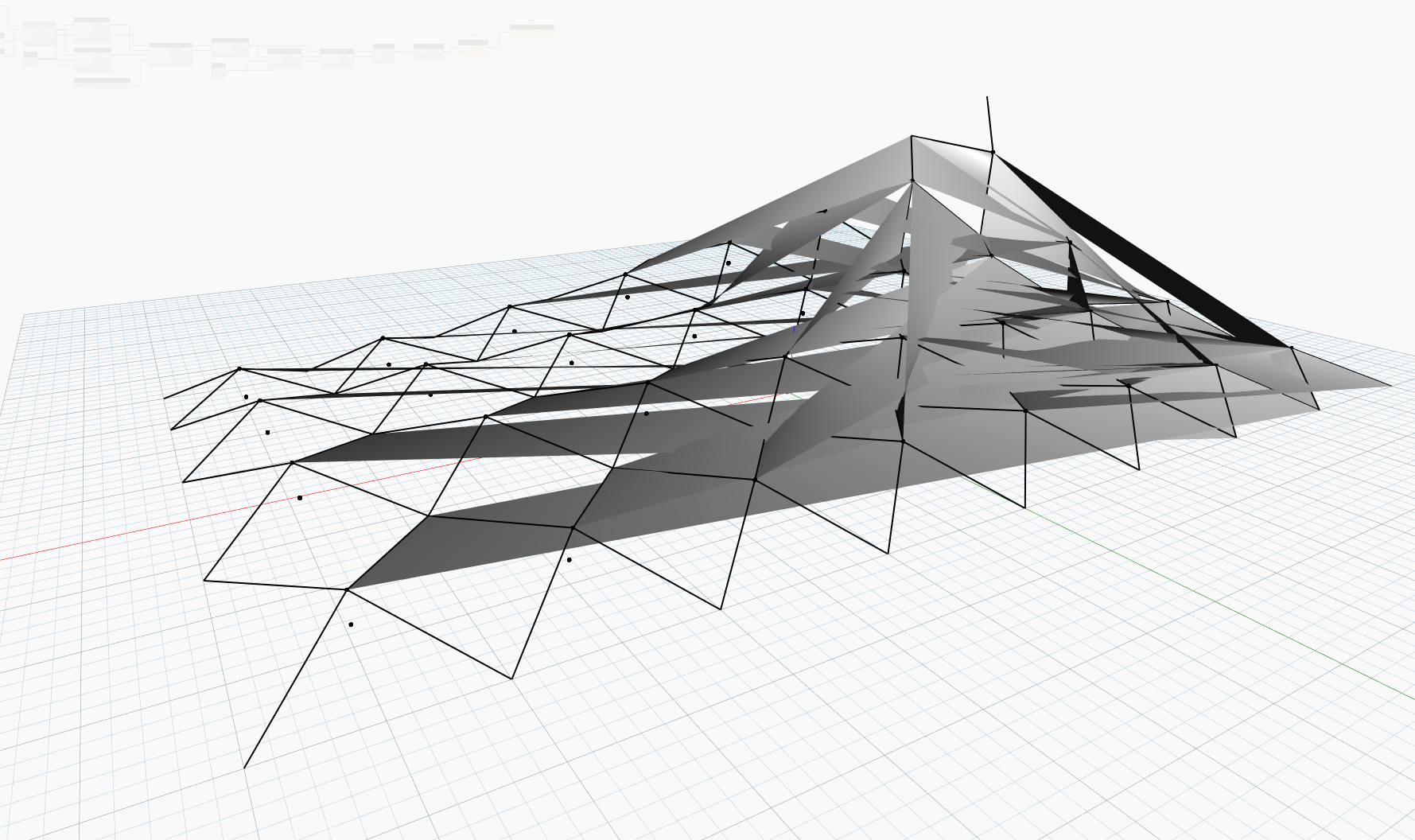

Hi again! I also tried your first proposal. But I have trouble with the loft nodes.
Do you know why or my mistake?

you should try to add a flatten node between Geometry.Scale and Panel.PanelQuad . If it doesn’t solve the issue then could you please upload your .dyn so I can have a closer look at it?
Unfortunately not solved. Thank you very much for your time!

just delete that List.Flatten Node. There was just a slight list structure difference between your example and mine :
Hi Mostafa!
Merci beaucoup! Now it works!
