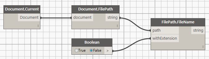

do any of you know if it is possible to get the name of the model your dynamo script is working in ?
i know it is possible to get the name of the linked models
the reason why i ask is because, i want to make an Excel export with the model name + something extra from a string
thanks in advance
Awesome :slight_smile: that work nice
If i want to add something to the end of that string, do you know how i do that ?
The easiest way is to use a code block containing this line:
filename + suffix;
Then just plug in the original filename and the string you want to add.
(Another way would be to use String.Concat node)
Thanks Anderas, that Work perfect
