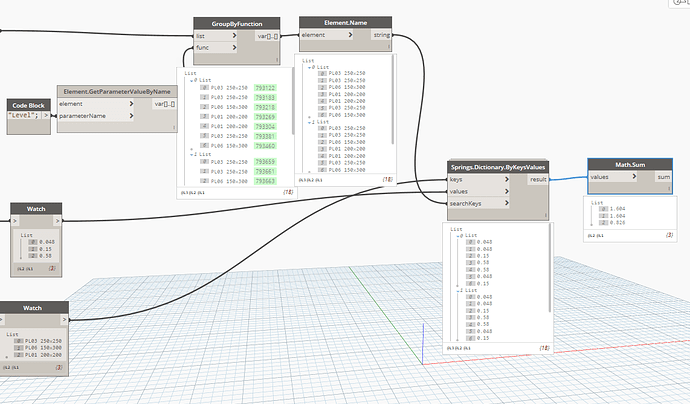

I have a program that gives me the elements in each level (the pink part of image) and also gives me a number for each element (the blue part of image), I want to get the summation of these numbers for each level, Please help me to do that.

Well, as some in here know… I’m fond of dictionaries.

it works correctly in my program (but not with element.name component, it works with element.id component, because i have different values for elements that have the same name). now my problem is that i want to get the summation of numbers in each list, for example in the image that you sent i want to get the summation of numbers in list 0,1 etc.in other words i want to get the output of dictionary code block in separate lists like the output of groupbyfunction component or element.name component in your image.
Yeah… I just saw that my graph didn’t return the nested lists… A number of ways of doing it, but you can use the dictionary node from the spring package instead, works exactly the same but dynamo takes care of list levels.

it works perfect!
