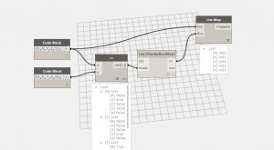

Thanks Michael. Could you look over and see what is wrong here? I get null values when I do cross-product.

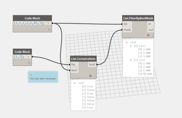

your problem is your list order. You are trying to mask a nested list on a regular list. In my experience, List.map sometimes works “only with numbers”.
But maybe the [List.ContainsItem] node is the better way for your purpose:
But I’m not sure if it works with IDs.

I just got a chance to look at this again (busy week) but I should explain a little better as my example wasn’t the best reference to what I am looking to do. What I am specifically looking for is to be able to find which item per subgroup is true. I’m comparing a column in excel to an element identifier in the model so when I get a true statement I want to get the correlating information from the adjacent excel columns to fill parameters in the element. I’m looking to do each run the whole list for each element (which works cross product) but now I need the sublists true fill collect the information. Michael suggested list.map but I cannot get it to work for me as shown in my example, I don’t have much experience with this function so I assume I have it connected incorrectly. List contain works but it doesn’t allow me to get the correct information from excel (at least that I can see).
