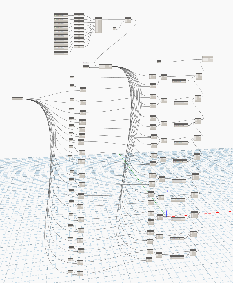

The purpose of this whole graph (the rest of it is too large to show clearly in one image) is to have dynamo read the calculated air flows, and then switch the terminal boxes to correct sizes. It works as it is, but currently it looks like this (and I know you can’t read the nodes in this image haha), and I have a feeling I can make this easier for my mech group so that they don’t have to keep selecting individual family types:

I tried the nodes that you showed, but at the List.Map, the watch node came out “empty”. I did, however, sort of combine some elements of your last solution with what I was already working with, and managed to get it to work, as shown in the image below. So, success on the original question, finally! However, it now fails when I connect it to the rest of the giant graph below
I can’t tell what the exact problem is because I cannot see the entire script, I suspect it is to do with the fact that you are not feeding lists of the same length into the nodes.
