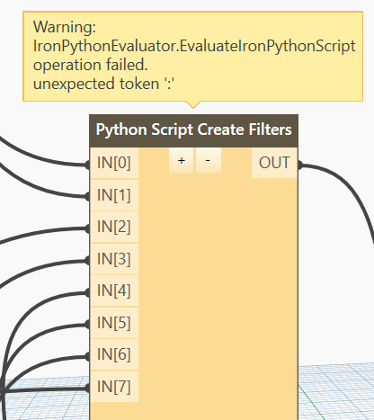

Hi Konrad
I tried to give it a whirl but another error is preventing the Graph to run. The error says “Unexpected Token ‘;’”
import clr<img src="//cdck-file-uploads-us1.s3.dualstack.us-west-2.amazonaws.com/flex022/uploads/dynamobim/original/3X/2/5/25d016a7a092dfe7b6454b6075db1b28ebd8734e.JPG" width="336" height="451">

you are missing a ) at the end of the line there
