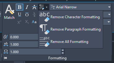

You can remove manually by editing the MText, select all and remove the formatting from the ribbon > Formatting > Clear > Remove All Formatting

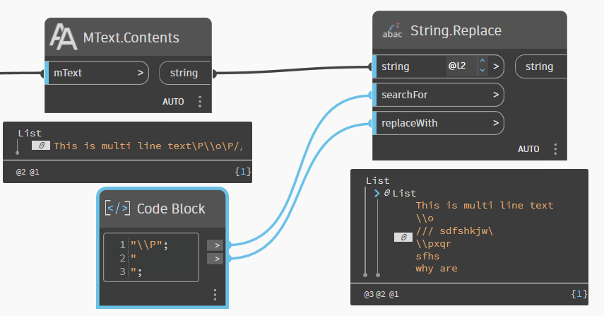

Then replace the paragraphs like this
