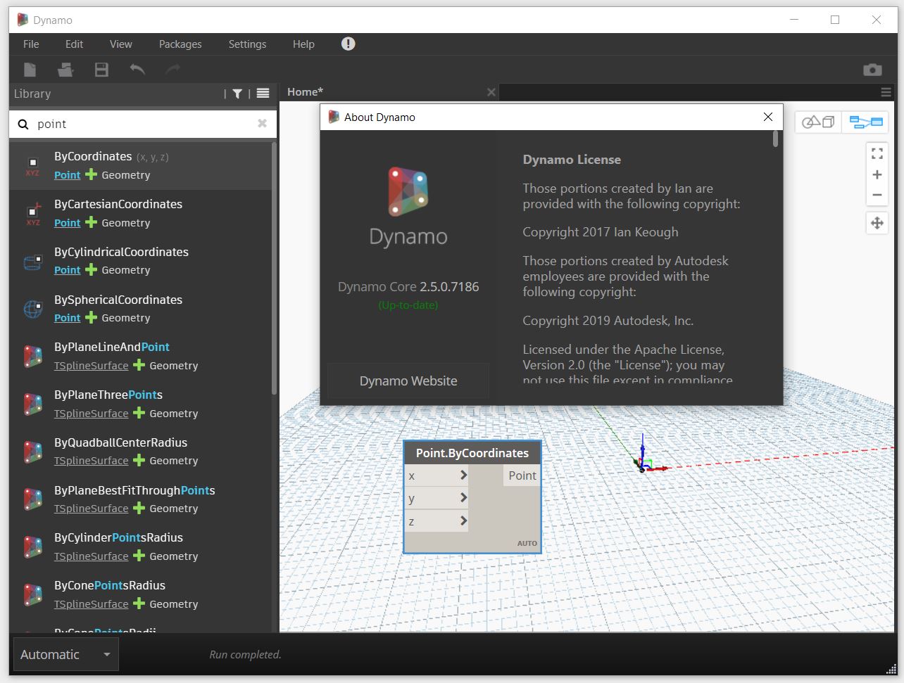

Is this still true? Is there any way to use geometry inside Dynamo without having one of those programs installed?
Yes.
Dynamo Studio would do this. However you are capped at 1.3. For newer builds there is no solution without the additional programs at this time.

Hello @J.Rymer,
Any of the Dynamo 2.5
daily builds should work fine with this - For example, the latest of: DynamoCoreRuntime_2.5.0.7186_20191220T1456.zip
Can you please let us know exactly what you are typing into your Terminal / Command Prompt
@solamour it works perfect now ! I think es had to do with the version of the Dynamo I was using. Thank You a lot to you and @Michael_Kirschner2 .
Brilliant! Glad to hear it
