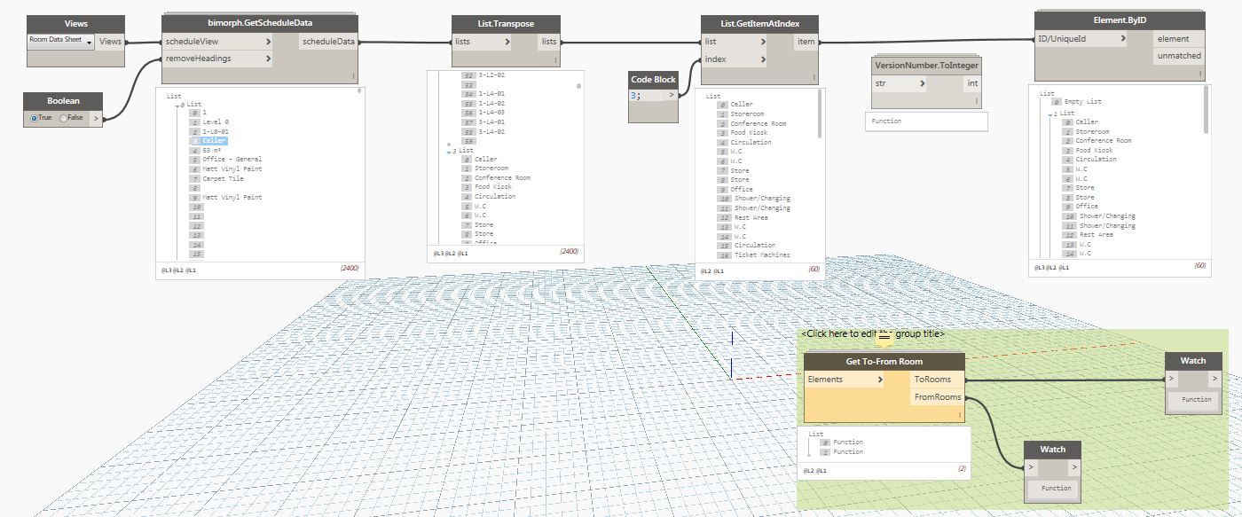

I tried and got to a solution for the query. my next step is it now to match my door ID together with my filterd Room ID. As the script should only run in Revit, it isn´t necessarily to get the Unique ID, but thanks for the recommendation.
Regarding your recommended links I did my next step, get all my room ID´s. The next step should be a query for: Every door, opened to a cellar and storeroom, must have a width of ≥ 0,50 m
I was thinking about using get to from room.
maybe you have a better idea how to connect the Element.ByID dirrectly with my doorID and list then together.
