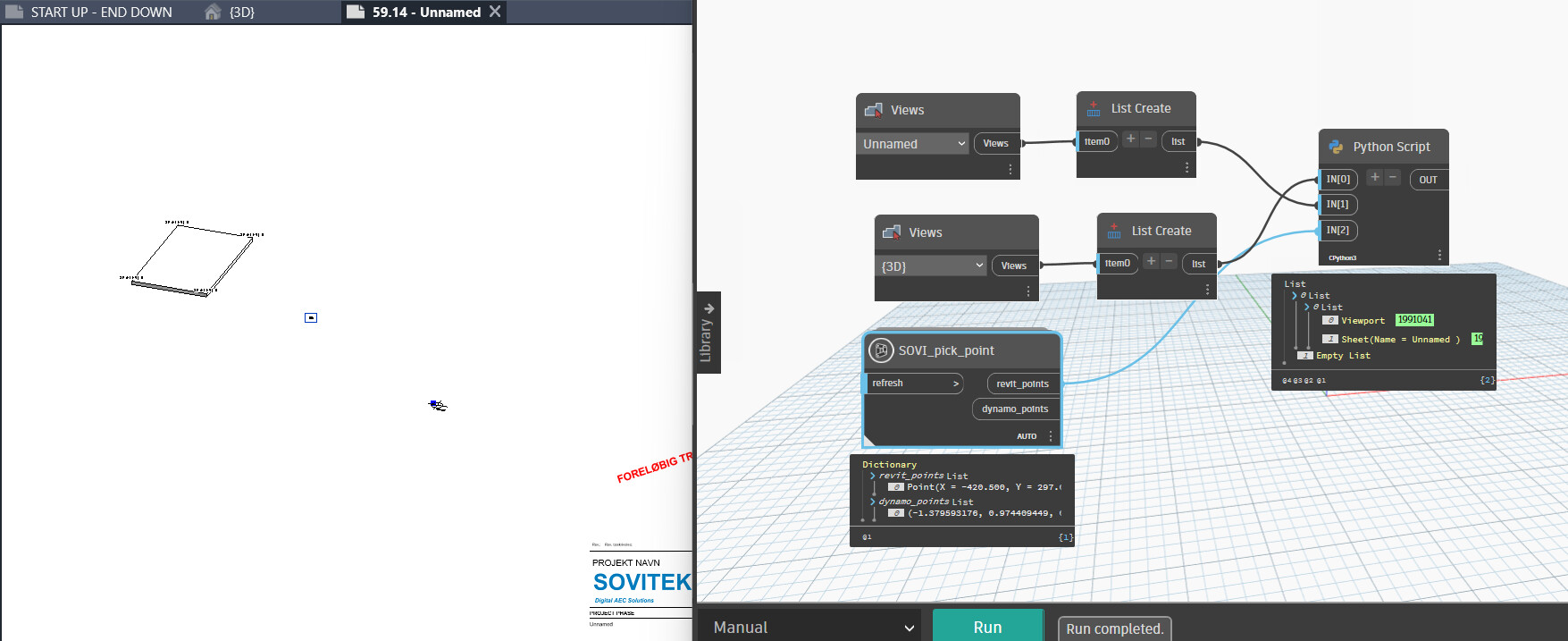

I tried to use your script but I get the following error:
type object ‘Viewport’ has no attribute ‘CanAddViewToSheet’
Is it a data corruption thing?
It starts to look odd :confused:
hmmm…which revit are you in ? i can try go deeper into that but first tomorrow, will be in waste of time "BIM coordinates meeting rest of the day, so i will only be online :wink: :wink: :wink:
ps just for test, try OOTB viewport create node and test if that works, not sure if that node first come in 25, or try rhythms viewport create node
I’m working with Revit 25.
I reinstalled the archilab package and problem solved :upside_down_face:
I upgraded Revit recently, so maybe some files were dragged from the old version…
It also seems to work only once. To make it work again it I need to restart Dynamo… :man_shrugging:
