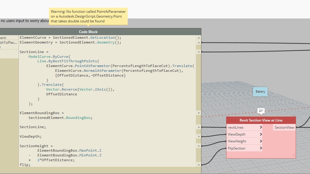

i use your file dyn, it is not activity
 ![13](https://us1.discourse-cdn.com/flex022/uploads/dynamobim/original/3X/6/1/61f7884eba9ac252cc12fa4d0b36fd9bbd8d07c9.jpg) ![12](https://us1.discourse-cdn.com/flex022/uploads/dynamobim/original/3X/7/6/76e9766ad230918bf75cf6b878a5d6dfe3a75ce2.jpg)
[Project1.rvt](https://forum.dynamobim.com/uploads/short-url/xw8X2WXAL2vJqchEs7agYOQq1wf.rvt) (2.8 MB)
[Section View - Create by Element and Trace with Detail Lines.dyn](https://forum.dynamobim.com/uploads/short-url/3GQPIxucG9Z6JzdIIjz0bFNpl1a.dyn) (14.3 KB)
thanks you

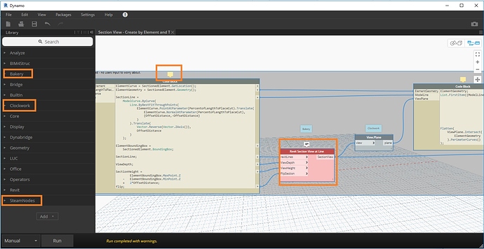

You need to install the custom packages noted above the respective nodes.
Bakery.
Clockwork.
Steam Nodes.
Get them via package manager.

i dowload and instal these packeges.
it is not activity
There has an highlighted event has occurred

What do the errors say? Can you also preview the outputs used later in the script?

These errors I showed in the first comment

What type of element have you selected?

Also bakery may have changed the name of the create section view node. Double check to find that one.
