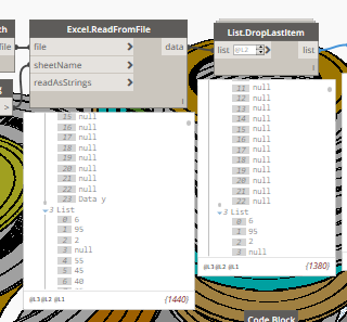

Just as a first thought… Your colours might be more easily managed via excel as well? You can just feed the lists into the colour node…
I think you maybe need to drop the last item after the info is read, you’ve got a stray column at the end…
Thankyou! I did not know you could feed the values into the RGB Node like that, however does this affect the colour range? Also I need each individual ring to be coloured separately, at the moment it colours each of the rings around a point as the same colour. Is this due to the surface?
Ah thanks, I was using clear list to get rid of null values.
