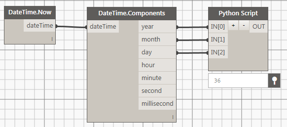

This one’s a bit shorter:
import datetime
year = IN[0]
month = IN[1]
day = IN[2]
OUT = datetime.date(year, month, day).isocalendar()[1]
grafik
it might not be as accurate but it’s short and simple :slight_smile:
