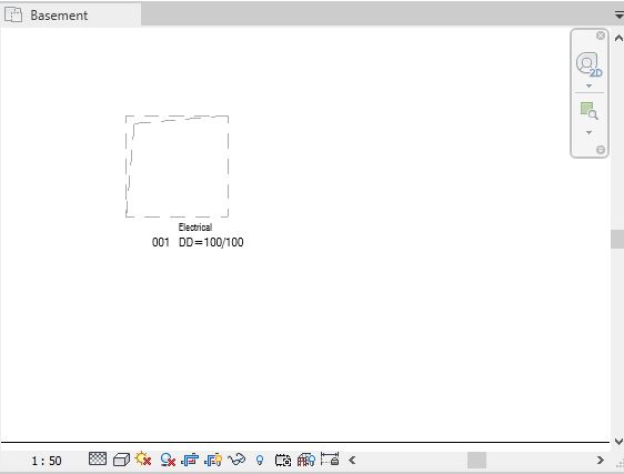

I’m wondering if it is possible to change the text in a Generic Model Tag based on the view on which it is placed.
I have a floor opening that I need tagged a few different ways. On the 1st Floor, for example, I need it to read ‘FDB’ (for finished floor opening) followed by the size. On the floor below, where the opening is seen in the Underlay, I need it to read as ‘DD’ (for ceiling opening) again, followed by the size. (I changed the text parameter for each of the screenshots so they would display correctly.)
So my question is: is there a way for Revit/Dynamo to know on which level an element was placed and tag it accordingly? Thanks in advance!
