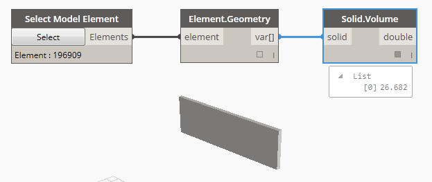

I am making a script that will give me area and volum information from a selected element, but…
I cant figure out how to get the volum info from the selected element
I want to be able to chance coulor when i Select for exemple code Block 1( at this point every code block is showing the same coulor).

The element Iam selecting is a concrete wall( se Picture) and is part of a bridge, abutment I think it is called and I want to get the volume from this element.
the second question: I want to add color in dynamo, the blue wall that is shown in the Picture, I want to be able to chance that .
To get the Volume use Element.GetParameterValueByName and use the Select Model Element.
