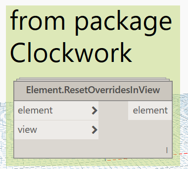

Also is there a way to undo any selection of colour? In the picture below, I want to colour the single AHU in red to show it hasn’t been named yet, and not apply any colours to the other 7 AHU’s. Obviously I can just not attach any colour to the other 7, however when it’s switching from the coloured box to the non-coloured box, the colour remains the same, hence I need to reset the colour to its original

In Dynamo we can only do what is possible in Revit. The way you override in Revit is a different method. The alpha on the color nodes will primarily work with Dynamo geometry, (to my knowledge).

@john_pierson I’m not too worried about the views anymore, as I can just put it into 3D so all the correct pieces of equipment are selected. I’ve had a look at the links you sent but I’m not really sure how to use them. Surely there’s a simple solution to reset the colours to their original settings? I’ve had a look through the packages available but haven’t had any luck
