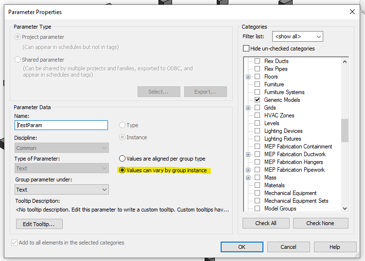

For some reason it makes me ungroup doors that are within a group with other elements. This issue I would very much like to circumvent… Do you have any suggestions about this?
<div class="post-metadata">
**Author:** ![Thomas\_Corrie](https://sea2.discourse-cdn.com/flex022/user_avatar/forum.dynamobim.com/thomas_corrie/32/63060_2.png) [@Thomas\_Corrie](https://forum.dynamobim.com/u/Thomas_Corrie)\
**Post date:** [November 14, 2019, 9:59am UTC](https://forum.dynamobim.com/t/adding-more-filters-to-sort-schedules-with-dynamo/43059/11 "2019-11-14T09:59:08Z")
</div>
Which parameter are you writing the combined data to? In my example I used `Comments` which perhaps wasn’t the right one to use as an example because it is a builtin parameter that doesn’t allow the value to vary by group instance
 ![image](https://us1.discourse-cdn.com/flex022/uploads/dynamobim/original/3X/1/c/1ca9eb0e01002f13dcf112e376c70bcce3c91f0f.png)
If you create your own parameter, or have one that can be modified then try using _Values can vary by group instance_ in the Parameter Properties. In this example I have created a parameter called `TestParam` and it seemed to work well
 ![image](https://us1.discourse-cdn.com/flex022/uploads/dynamobim/original/3X/f/8/f80d473c71fce05eda332040662877dad556f6df.png)
