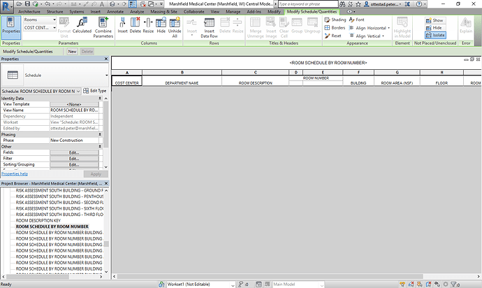

you might have unplaced rooms that spoil things
I never thought of that but I don’t see any unplaced rooms in schedules.
No rooms?
Can you make a new schedule without filters?
This shows the full schedule. No filters.
Can you sort on area?
Unplaced/Unbounded rooms have no area.
Mmm…
I want to ask you again to make a new schedule, no copies, its important that you do so
