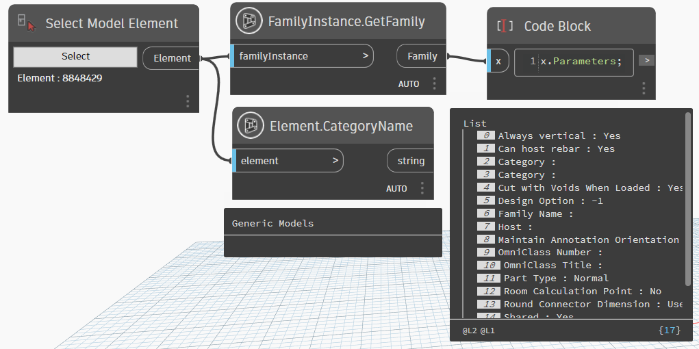

So it’s possible to add this parameter to a generic model using API!! …by reading the link you have put I could understand that Revit lookup can give the path of this parameter, however the code I’m looking for is not given and I dont know how to get it using Revit lookup?..so any help will be apreciated
@staylor In your sample you selected a structural family where host rebar is a built In parameter, and you dont need to set it…but for my case the created generic model family doesn’t have this parameter.

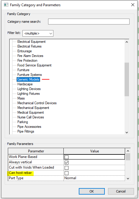

Actually that is incorrect. As shown, it’s a generic model category. Originally I edited a structural framing element family and the parameter was not there. As soon as I changed the category to Generic Model, the parameter showed up. It is a built-in parameter as @Nick_Boyts stated. As shown below, “Can Host Rebar” is a family parameter of a Generic Model. The parameter is not available for Structural Framing.
