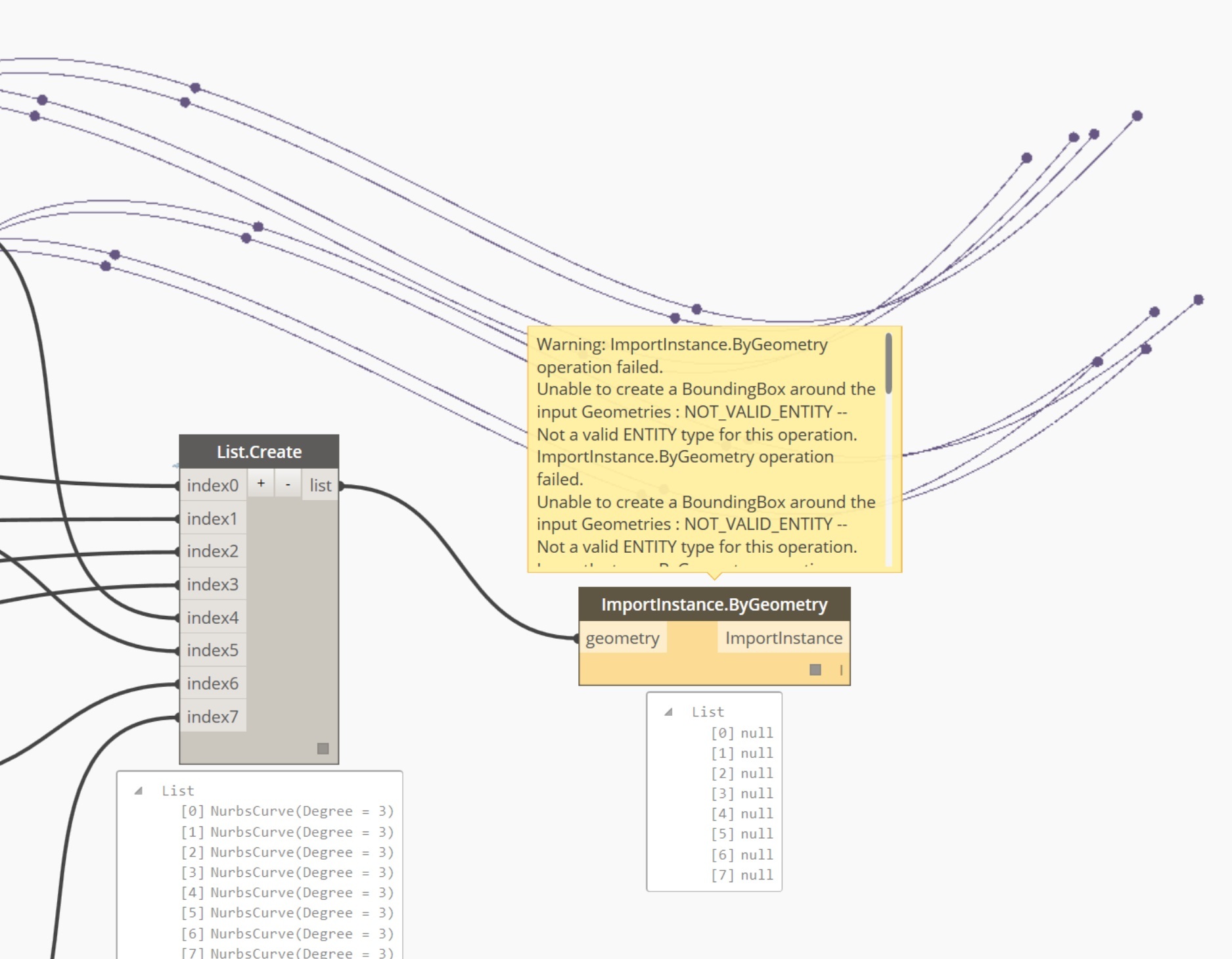

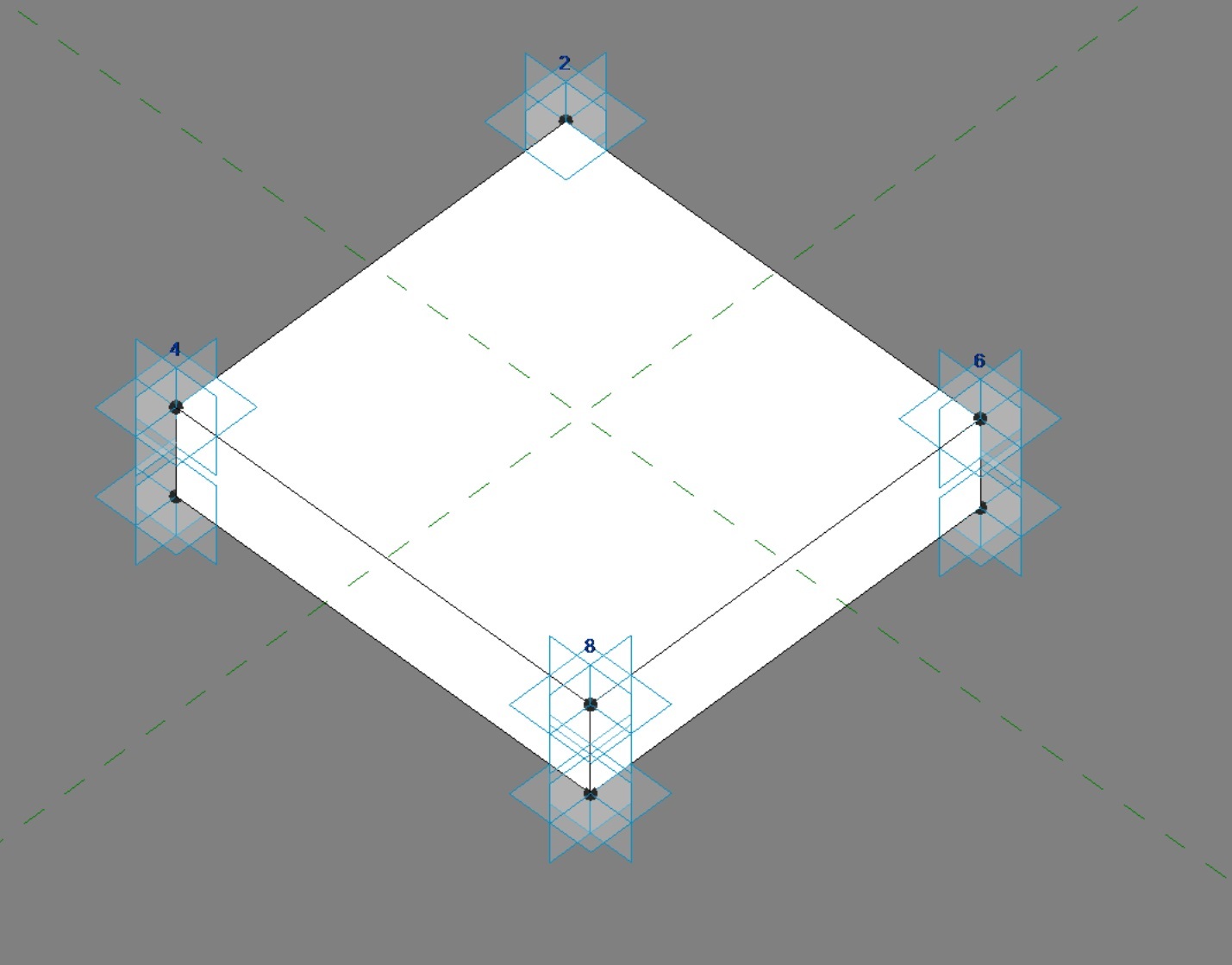

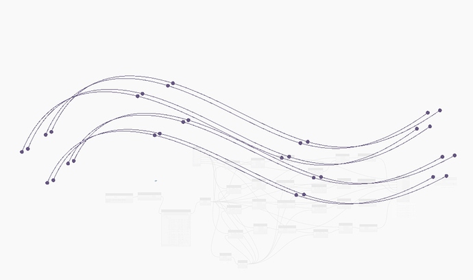

I am trying to visualize the 3D swept path for a 8-point adaptive family in revit.
Would it be possible for me to import nurbscurve into revit?
I am using Revit 2014 and Dynamo 0.8.2 for this task.
Thank you in advance.
